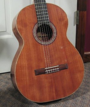

I made a redwood/bubinga classical a while back. I hate to say that it probably turned out to be the worst guitar I've made to date. But thats not to say that someone could not make a good sounding classical with redwood. I think I left my top a little to thick. The worst problem with it is volume. It's to quite. The treble is also very mellow.
Here is a picture of it.
